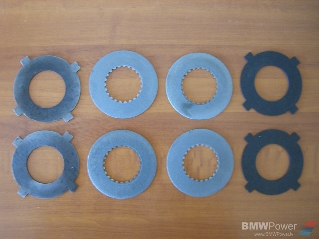

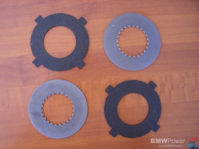

Postby sjava » Sun 13. Jun 2010 13:51
For replacing
and if u want 45% LSD
www.hgksport.com
